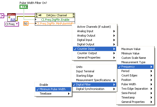

Hi mlang,
Something you might want to consider is, if the ringing is guaranteed to have a smaller pulse width than the motor pulse, then you can use a counter task with the channel property node of Minimum Pulse Width.  This can be seen in the following image.
With each rising edge of the signal, the timebase will begin counting, and if the signal drops off before a certain amount of time has passed, that portion of the signal is discarded. Only pulses of a certain duration are passed on to have the frequency measurement taken. However, this will only be effective if your TTL signal has a longer duration then the ringing noise you are seeing.
Other than this, I would suggest finding the cause of the noise and trying to reduce that. Everything we have previously discussed is more of a bandage, instead of addressing the root problem.
Hope this helps, Mallori M.
