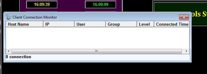

This issues has been happening about once a week, my clients are losing connection to my server randomly at any time. When i view the client connection monitor, my list is blank. Sometimes when i open my server file i get an error "process registration failed". Only way for me to get the clients back is to restart the computer. I have already tried to repair lookout program by reinstalling and tried changing the National Instruments PSP Server Located to automatic in services. http://digital.ni.com/public.nsf/allkb/622F4C13A00A4C6786256DC600571783.

I still having the same issue, i noticed now that when i monitor my client connection monitor and when i get 65 clients. It would drop some of the clients out and tries to reconnect.

From your attached picture, National Instruments PSP Server Locator was started and its startup type has been set to automatic,  was your snapshot caught when this problem occurs? What about your lkads.exe? what's the status of lkads.exe when or after disconnection occurs?
Can you ping the target or connect with an FTP session after the disconnect occurs? Also,  I wonder if CPU load could be the cause for this problem? can you check that?

i took this screenshot right after the connections drop. To get the connections back i would have to restart lookout and wait for a few cycles of clients connecting and then dropping back out again.It would take about 5 minutes for connections to stabilize and hold connection in my client monitor.
