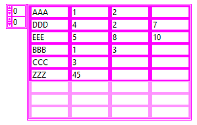

I have several arrays (grouped inside a cluster) with two columns : header is in the first column, value in the second column.
I want to have an array with only unique headers, and values.
I manage to have unique headers, but the problem is unique data. I've attached the VI. I think the problem may come from "insert into array" which I believe cannot insert on a row that doesn't exists yet?! Can you help me?

One problem is that you represent integers as strings, so an alphabetic sorting of the numbers of each row will not be sorted numerically. Do you care about the sort order of the numbers in each row? If not, a variant attribute based solution is especially simple, but with a few minor tweaks in can also be adapted for the numerically sorted case.
Here's how that could look like.
(To sort the numbers numerically, you could do a "string to numeric--sort--numeric to string" before the lower input of the last "built array". If you would zero-pad the numeric strings so all have the same length, you would not have this problem. Modify as needed).

@haha1234 wrote:
but... imagine I care about the order ? Is there a way to do an alphanumerical sort (just like files in windows folders)? Example 11 before 99 before A1 before B1 before B2 etc...
The variant attribute method will always be sorted alphabetically. No extra code needed for your examples. However "11" will be before "2" unless you call it "02"..
Windows explorer (in newer versions of windows!) will do a mixed mode if parts of the file name are numerical. You would need to implement that yourself. I already mentioned where that sorting step would go.
