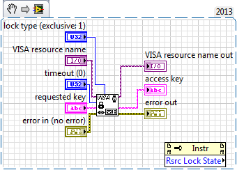

Use VISA Lock Async.
Your main program can periodically poll the resource lock state and disable the locked VISA Resources.  Make sure you keep a list of "MyLocks" so you don't disable control of instruments that specific bench is using.

Jeff,
I don't think the lock works across different computers.
Message 14 of 19
(1,883 Views)
It won't.
Maybe if you setup remote VISA and share the resources through that, but that is really just complicating the setup even more (albeit might allow to get rid of the LAN extender).

@Dennis_Knutson wrote:
Jeff,
Right of course-  But updating a NPSV with Lock Status is fairly straight forward

Hi again all,
Jeff, can you explain a little more?
Message 17 of 19
(1,845 Views)
NPSV= Network Published Shared Variable
All of your "User" Systems should be able to write and read to a "Master" location to share information about the usage of the shared devices.
e.g.
  • User A looks for availability of devices it wants by reading the "Lock" or "Checkout" status of the desired devices
  • User A checks out those devices it whants to reserve
  • Begin using reserved devices
If user B wants those devices the NPSV will let them know it is in use already (Hopefully with some additional info like, the name of User A)
  • User B can tap on the cube wall of User A and negotiate whos experiment is more important
  • User A doesn't really need the data so he releases the locks and User B sees that the devices are available again.
-Rinse-Repeat
