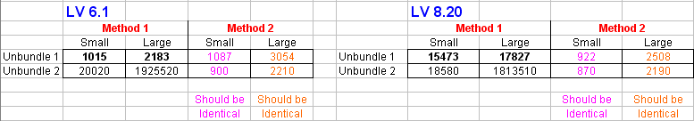

Regarding the discussion which has gone on before regarding a big performance penalty when operating on otherwise in-place arrays within and without a cluster:
Ben correctly stated that arrays within a cluster carry a significant overhead and that handling non-clusteres arrays are faster.  This has been verified.
I have trouble understanding WHY this is.
I've just repeated some of the tests mentioned in the original post, but in LabVIEW 6.1.  Here I see that a clustered array with the cluster carried forward as in:
This is "Method 1" Unbundle 1
is just as fast as handling the naked arrays (a shift register for each array separately with unbundle / bundle OUTSIDE the loop) in LabVIEW 6.1 regardless whether the second array contains a load of data or not.  In LabVIEW 8.20, it's significantly slower.  Something changed between 6.1 and 8.20.
But when unbundling BOTH arrays as in:
This is "Method 1" Unbundle 2
, the clustered arrays are still an order of magnitude slower than naked arrays.
Referring to the version working directly with clustered arrays as "Method 1" and non-clustered arrays as "Method 2", here's a table of results I've just measured with the attached program:
"Small" and "Large" refer to the size of the second array element in the clusters being tested.  This array is actually not altered during testing.  Times are given in milliseconds.
I used the following settings for the "unbundle both" version and 1000 repeats for the "unbundle 1" option:
Final results were scaled to 1000 repeats to allow direct comparisons.

Ben,
I'm at it two DAYS now and I still don't know what's going on.
I've taken your new suggestions to heart and made a new version.  I've changed the "Append array" to "Replace array subset" and have moved the indicator update outside the timing structure.  I also programatically generate the clusters involved and have put all relevant settings on the front panel.
In this VI I test 6 different methods.
Method 1 is the "Naked array" method shown below.
Method 2 is a Clustered array with one unbundle output wired and a cluster wire passthrough as shown below.
Method 3 is a clustered array with both unbundle outputs wired and a cluster wire passthrough as shown below.
Method 4 is a clustered array with both unbundle outputs wired and NO cluster wire passthrough as shown below.
Method 5 is a clustered array with one NAMED unbundle output wired and a cluster wire passtorugh (obligatory) as shown below.
Method 6 is a clustered array with both NAMED unbundle outputs wired and a cluster passthrough (obligatory) as shown below.
Running these with the VI attached (saved under 8.20 for LV 8.20) and the options shown on the diagram, I get following results:
NOTE:  Columns for Method 3 and 4 are switched.  The labelling is correct, "Cluster 2 no Thru" is for the clustered array with both unbundles wired and NO wire passthrough!
I thnk this is correct, but for the life of me, I can't explain why naked arrays are slower than clustered arrays in LV 6.1.  I think I might need to move the "unbundle" and "bundle" for this case outside the timing structure.  What do you think?
From my results in LV 8.20, it would seem that it makes no difference whether we are working with clustered arrays or bare arrays, just like the LV documentation says.  I never thought of the indicator update issue you mentioned earlier.  I was stuck in "data-flow" and I thought it would be finished updating before carrying on.

Hi Shane,
Attached is a revised version of your “Cluster pointers 8 6.1.vi” saved as 7.1.
The changes I made were;
1) The GUI updates could happen while other tests were running, move it to happen after all testing was done.
2) Add a default case so case “0” does not get special treatment.
3) Remember result (data) from each method so that the output buffer work is the same for all. Note: I believe LV will skip transferring data to an output tunnel data buffer of indexing is not enabled until the last iteration.
4) Used index value to as replace element to prevent constant folding clouding the measurements.
5) Wired the cluster around on method 1 to tell LV it was OK to re-use the input buffer as our output.
After a few runs I noticed my No-op was taking about as much time as my other best. This implied that the control logic ( selecting which method) and over-head (filling input and output buffers) was dominating the measurements. I tweaked the test parameters to invoke the control logic less often and beat the code we are trying to characterize harder. I saved my defaults (warning: Due to method 4 a test run takes forever).
This is how I read it.
All methods use an input Buffer “A” and an output buffer “B”. This includes the default  method. The default method required about 300 ms on my machine to fill the input buffer and transfer it to the output buffer.
All methods that only required an input and output buffer ran about the same speed. I suspect under my default settings,  the measurement time are indicative of the time required to fill input buffer and fill output buffer. To get a better measurement of  the time require to execute each method I will have to tweak my measurement parameters again. Since method 4 is so inefficient I will stop using it my tests. Before I forget abou this method I will venture some guesses about why this si so bad.
The SR is realized by working in the input buffer. Each iteration copies the contents of all of the buffers in “A” to “C” and back to “A” again. No wonder this takes so long!
Now for a suprising issue.
Compare your method #2 and #5
And then #3 and #6
The differnces appear to be tht in the case of unbundled vs unbundled by name. In the case of the unbundled by name we pick-up an extra buffer copy to fill the buffer that is allocated for the SR.
Q : Why isn’t  buffer “A” used to support the SR for the “by name” version?
Summary;
Building a cluster with large arrays (method 4) is costly.
Something weird is happening with unbundled/bundle by name.
Further study will be required to measure the performance of the buffeb A-B versions.
I’ll post more when I know more.
Ben
Message Edited by Ben on 02-24-2007 12:01 PM
Message 8 of 30
(12,693 Views)
And if you deletemethod 4 and wire the cluster through you eliminate the need for the output buffer!
And of course the performance jumps due to less buffer copying.
Ben
