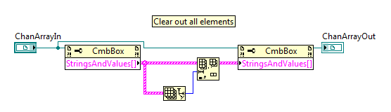

I'm planning for the possibility of re-populating my list while the VI is running, and during development, I noticed that the control gives an error if identical elements are entered (I ran into this when re-populating it with the same strings), so to avoid that, I thought the easiest was was to clear it out competely first...Here's how I did it in my new subvi...
Thats an 'Array Size' vi on the bottom, and a 'Delete fromArray' above and to the right of it.
And, yes, this is a compiled executable, with different ComboBox lists so I have to be able to populate the list 'on the fly'.

ah, ok.  that works, and it's kind of clever.  but it's just deleting the whole array, so you could just wire a null array constant to the write property node and eliminate the read PN.
note the right hand error case of PJS's code is a routine for  adding one item to the combobox's list (checking first to see if it exists).
It's also a good habit to use the error wires
