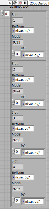

Additionally, I tried running the example code from https://forums.ni.com/t5/Example-Code/Programmatic-Discovery-Configuration-and-Access-of-CompactRIO/....  After putting my RIO in scan engine mode and deleting the FPGA bitfile, I ran just the 'discover io.vi', slightly modified:
This gives the following front panel outputs:
The outputs are the same if I have modules in the first four slots and if all of the slots are empty.  I refuse to believe this particular result, so I then loaded an image I made of my original program that didn't include the FPGA (scan engine mode only with module discovery).  I run that (as an executable), and it detects all modules and IO variables correctly.
After that, i run the 'discover IO.vi' from above, and it works as expected.
From all this, I understand very little, but it seems like that the version of my project that uses the FPGA in hybrid mode does something very, very bad to my RIO.  I just have no idea what it is.
