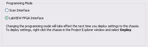

Hybrid mode requires that you have a compiled bitfile running on the FPGA to be able to read Scan Interface IO Variables.  Moving the module from the FPGA target to the RT target will enable the Scan Interface for that module, but the chassis will still be in LabVIEW FPGA Interface mode.
To get just scan mode access for the chassis, right-click the chassis in the project and choose Properties.  Then, change the Programming Mode to Scan Interface.  If you still want to use FPGA programming and the Scan Interface together (hybrid mode), you will need to compile a bitfile (empty if you don't want any programming on the FPGA yet or containing your FPGA code).  By compiling, the scan mode module support for the modules under your RT chassis will be compiled into your custom bitfile.  Then, on your RT VI, you will need to use Open FPGA VI Reference to your newly compiled VI.  Once this VI is deployed and running, you will get data from your the CIE.
