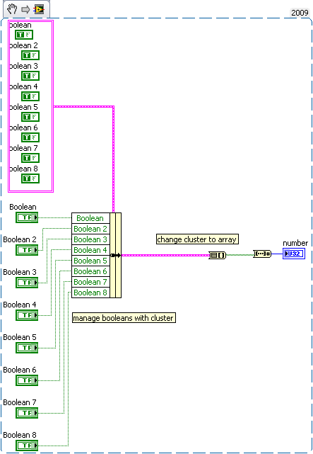

Does the following code snippet help? By the way, 32 booleans is a lot, so I'd manage them with a cluster if I were you. That will reduce the possibility of errors (wiring boolean 8 to boolean 9's positions, etc...).

Sorry, i didn't say it clearly -
The input is an array of double with each element having boolean value.
What I can think of is to convert each element to be unsigned 32-bit, left shift each element, and add all elements.

"array of double" meaning a 2-D array or an array of double precision numbers?
Maybe you could post a picture or your code?
I will assume each float can be either "0" or "1".
Yes you could use that approach but you would have to reverse your array such that the first element is weighted as the "ones-bit".
There are many other ways to do it. There are operators on the data manipulation palette that will arithmetic shift left, right rotate join split etc.
Have fun,
Ben
