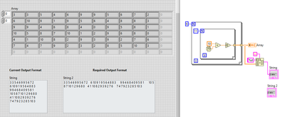

Sorry for the insufficient information. I hope the below image can explain you more about this. Updating to string is not a matter, but wrapping the string like below mentioned picture is my required thing.
The above mentioned picture is just for an example. But my string should look this.

Hi, please understand that, updating to string is not a matter. But, how the string looks, that's only my concern.

Hi Alwin,
Use SearchAndReplaceString on the result of ArrayToSpreadsheetString and replace all linefeeds by spaces!
ArrayToSpreadsheetString will always place linefeeds between rows of a 2D array…

I hope you meant this. If it is, it doesn't meet my requirement.

Accepted by topic author Alwin_Capsys
Replace linefeeds AND carriage returns
Paolo
Message 9 of 22
(3,971 Views)
We can only guess your requirements when you do not provide the VI. From the picture, I guess you want four spaces instead of EOL, so do:
