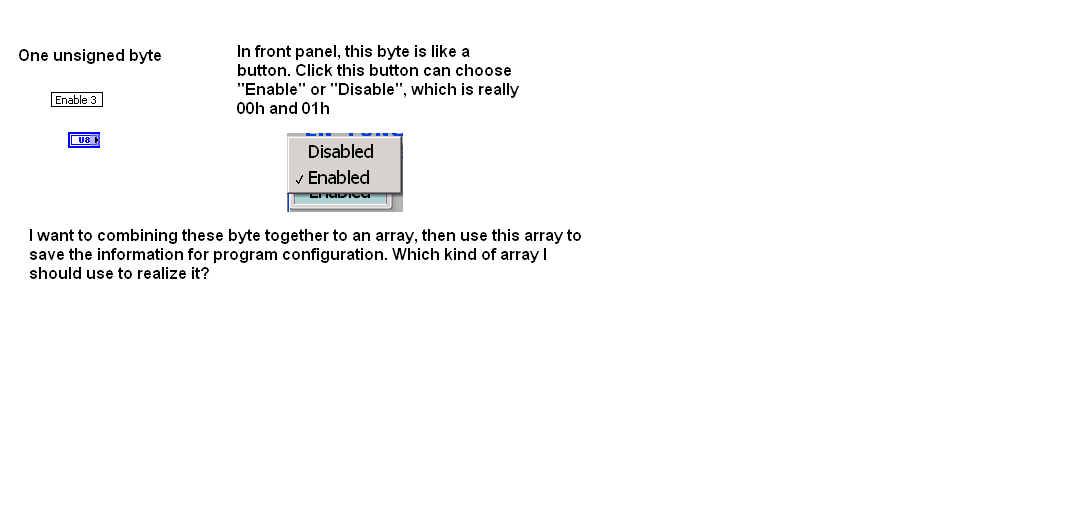

Which kind of array to choose for combining several unsigned byte
Hi, I have several unsigned byte variables, and want to build them together as an array for future use in configuration saving. Could any one tell me which kind of array I should use? Or should I use "build array"?1.PNG

Is your data multiple instances of some type of value or are you simply putting them into an array for convenience? If you are simply stuffing unrelated items into an array for convenience then don't do that. It will only serve to confuse anyone that comes along later to work on the code. Arrays should be collections of like data, not just unrelated things of the same data type. Also, if you are saving the data to a configuration file, do you want it to be human readable? Will people use and editor to make changes to the data? If so, then save your data in a meaningful way. In your case don't save 0 and 1 but rather save the value as "Enabled"/"Disabled". This is much easier for someone editing the file to understand. You can look at the examples that ship with LabVIEW for working with ini configuration files.

Hi Mark, thank you very much for your quick and detailed reply!And I will explain to you about my target then hope you can advise me more.
Like you see in the picture, I have a lot of items in front panel, and here I only showed one, its name is "enable". When we click on it, you can choose "ENABLE" or "DISABLE".
Currently what I have is a lot of related items (their function is independent). For example, I have three items, "enable1", "enable2" and "enable3". And all of them can be set as "ENABLE" or "DISABLE".
The final target is to put this array (or vector, or anything else you think the most suitable one) into the "save configuration file" diagram. I use the following picture as the template for "load the configuration". Could you tell me which is the best way to do? Thank you very much!

I think you would be better off saving these items individually. It is a bit more work on the code side but it is much easier for a human to edit the file. Use a traditional ini file format such as:
[Application]
Station 1 = Enabled
Station 2 = Disabled
Logging = Enabled
Stop on Error = Yes
This is much more readable for a person. I recommend this sice you are saying this is a configuration file. Generally these will be open for editing by a person.
If you go with some criptic array format such as
Parameter = Enable, Enable, Disable, Enable
You can write a subVI that will return cluster containing your configuration settings. You would also write a similiar subVI for saving the parameters. This VI would also accept the cluster as an input.
the user will have no clue what they are setting or modifying.
