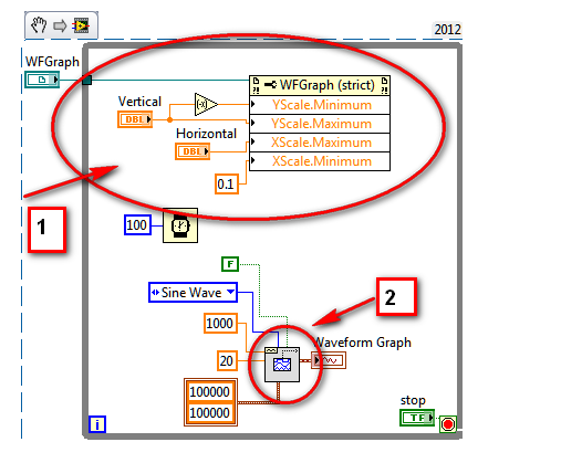

I'm looking for a virtual oscilloscope tha can acquire real signal via an USB card and visualize it on a PC.
Searching on the web I've found this that seems to me very simple:
At the same time I don't understand how it works.
I.e., I dont undertstand what are 1 and 2
Any idea?
Thanks in advance

1 is how you set the X and Y scales for the waveform graph on the front panel.
2 is a simulated signal generator.

Hi Tim.
Thanks for your reply.
I've imagined that 1 was a way to set x and y scale.
Otherwise, I don't know how to show this parameters:
In fact, If I put in my diagram a waveform graph, I don't see it:
 Any idea?
P.S. I'm a Teacher of Systems and Automation in an italian high school. I'm trying to create a basic oscilloscope for my students using a simple USB 6000 and only for signal of frequency not exceedING 1000-2000 Hz (only for teaching purpose)

Right click on the graph in the block diagram and create a reference. Then you will need to connect it to a property node.
You can also just directly create the property node with the scales in it mostly the same way. You will right click on the graph and create property node and then search for the correct property for the X and Y components.
Tim
GHSP
Message 6 of 10
(13,605 Views)
The problem is that the pictures you found were VI snippets which were created by the LabVIEW built-in Create VI Snippet.  The problem is that any property nodes that are implicitly linked to a control get broken and shown with an explicit link and a control reference.  (The Code Capture Tool found on LAVA is better in that it keeps implicitly linked properties the same in the snippet the same as they were on the diagram.)
Delete the Waveform Graph reference control and the wires coming from it.  Right click on the property node and select Link To > Pane > and drill down until you find the Waveform Graph you want to link it to and select that.

It seems to works.

You do understand that this is not really an oscilloscope, you are merely displaying the output of a simulated sine wave.
I would start here and select a USB oscilloscope
