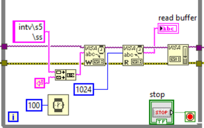

I am currently trying to get this CO2 Probe to accept Serial Commands without using Putty.
https://docs.vaisala.com/v/u/M210514EN-E/en-US
It uses RS 232 protocol. I am getting data however, when trying to set the interval to 5 seconds as shown in the User guide linked above(pg 34), it keeps outputting at 1second (unless i change it via Putty).

Hi Al,
What exactly do you send to your device?
Set the string constant (with your command) to "\-code display" mode (and set the display mode indicator to visible!) to check the string content.
Setting the TermChar usually defines the reading part, not the sending part (by default).
(The same applies to the "read buffer" indicator.)
I recommend to use the "right angle bracket" as TermChar for reading device responses. According to the "NOTE" in your image this will be the last char of each response…
And keep in mind: we cannot run/edit/debug images within LabVIEW!

Thanks for your timely response,
I dont know why the VI did not upload when i posted the question.
I recommend to use the "right angle bracket" as TermChar for reading device responses. Accordng to the "NOTE" in your image this will be the last char of each response…
Ah, guess i interpreted the note wrong, i thought it was saying to use ONE of the three, and just decided to do <cr>

Are you stopping the run mode before starting to talk? I would make sure that you are not in run mode.

Thank your Mr Tim and Gerd.
I took your advise with applying the display mode to properly understand whats happening in the command line and also about the TermChar not applying to Write, After applying the <cr> TermChar (\r) to the write, it began accepting the STOP command as Mr. Tim suggested, That allowed me to start sending commands to the Device(it was right there in the manual!😅)

Hi Al,
@AlAlexis wrote:
This is how the write portion of the VI looks now
You still don't show the display mode indicator at your string constant: right-click->visible items…
When you set the "run mode" to output data each 5s then you should set that once and not with every iteration.
Then you can run the read loop without any wait function as the device sends a command each 5s and VISARead will wait for the full message - as you hopefully defined the correct TermChar now…
