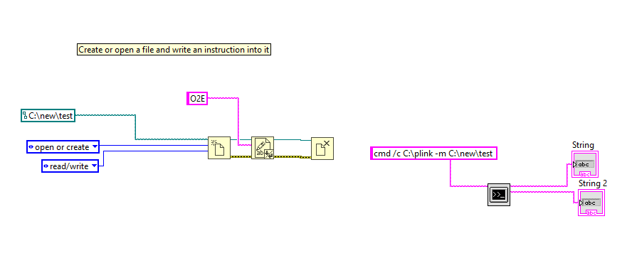

I finally find a way which might work :
 - At first I create a file with the instruction writing into it.
 - Then I use "cmd /c C:\plink -m name_of_the_file" on a command window.
I add a picture of my code.
I got an error in the String 2 :
'C:\plink' is not recognized as an internal control or external, an executable program or command file.
I check, I download PUTTY in the C so i don't realy understand why it doesn't work.
In fact I don't see plink anywhere in my file explorer, but I see in another forum than it is normal.
Thank again for your help.
Vincent
Message 17 of 20
(6,279 Views)
Accepted by topic author vincentREY4
Don't use plink. Just look at the examples for the VISA serial communications and communicate directly with the device using the VISA VIs. You will only need a few VIs. Your code will look something like this:
Mark Yedinak
Certified LabVIEW Architect
LabVIEW Champion
Message 18 of 20
(6,271 Views)
@vincentREY4 wrote:
For the last message, I mixed plink and putty, sorry.
Vincent
Man, there are so many things I think you aren't understanding.  For instance, plink.exe doesn't reside in your root directory - but I do believe it is in your PATH environment variable, so just plink -m... but this whole thing doesn't make sense.
How about, let's start from square one.  Tell us exactly how the engineer told you to do it from a putty session.  And I mean everything right from opening the session itself.
Bill
CLD
(Mid-Level minion.)
Message 19 of 20
(6,215 Views)
Your solution work. I thought I had to use PUTTY but no at final.
Thanks for your help everyone.
