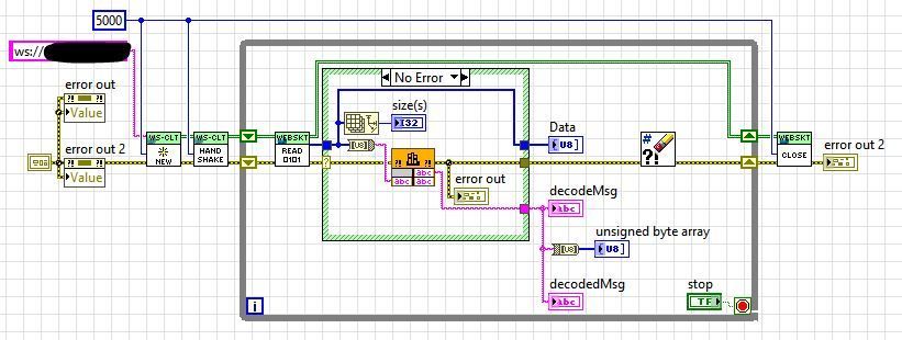

I have a LabVIEW program that communicates via TCP/IP with an electronic device. The messages exchanged are binary and serialized. To deserialize them, I call a Qt DLL that takes the encoded message as input and returns the decoded message.
In Qt, we use a QByteArray for binary messages. However, LabVIEW does not know this type of data. So I decided to exchange strings ( Qt and LabVIEW know how to convert byte arrays to strings).
The problem is that the CLFN does not return any data. Here is more information :
I have to decodedMsg : 1 in string, 1 in hex.
Here myDLL.dll :
std::string* myDLL::decodeMsg(std::string* receivedMessageString)
    QByteArray receivedMessage(receivedMessageString->c_str(), receivedMessageString->length());
    // Deserialize
    std::string response(receivedMessage.constData(), receivedMessage.length());
    return &response;
Just simply DLL that return what I send.
The response :
CLFN configuration :
I don't understand why I can't get a response.

setPower function into Qt DLL :
int myClass::setPower(char *receivedMessageString, char *responseMessageString, size_t *size)
    // Error codes
    int noError = 0;
    int buffToSmall = 10;
    QByteArray receivedMessage(receivedMessageString, strlen(receivedMessageString));
    if(*size <= response.length())
        return buffToSmall;
    qstrncpy(responseMessageString, response.c_str(), response.length() + 1);
    *size = response.length();
    return noError;
LabVIEW front result :
(not the same size, why ???)
LabVIEW diagram :
LabVIEW crash with this error (like a memory leak ?) : DAbort 0xF50EFD7B in MemoryManager.cpp
My questions are why the size of the message changes between input and output when it is the same message and why the copy works well but LabVIEW crashs ?

If you'd show the names in the dll (right click, Name Format, Names), we could actually read the code...
If a string is 2 bytes per character, it's probably using wide chars (2 bytes per character).
Message 9 of 11
(3,855 Views)
Yes, sorry. Here the CLFN :
Message 10 of 11
