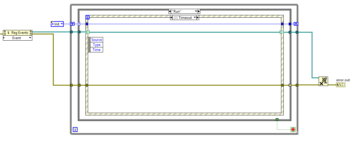

Hi Experts!
Can anyone please tell me the right way of unregistering events.
I'm puzzling myself if i need to connect dynamic event terminals or it will just do fine even its not wired up.

The first picture is fine - you don't need to wire through the Event Structure.

The event registration wire is odd in that it does not carry info but does associate the registration nodes with the event structure. It acts like a queue right down to case where if you wire a queue ref wire such that it branches to two or more de-queue nodes, only one of the two nodes will receive a given queued item.

Thinking some more...
All event structures theoretically have a dynamic event terminal but they default to not be shown.
We can expose them and even with nothing connected to them the code is not broken. So again we see that the dynamic event terminal does not expect any data. If it did expect data, then it would violate data flow in there was a sink with no source (I actually saw a bug like that in LV 6i and it was absolutely freaky seeing a wire with no source and runnable code!).
It is shaping up in my minds eye that the dynamic event terminal is a graphic gizmo that we can use to manipulate the events handled by the event structure.
So no need to wire anything to it unless we want to change the way the event structure operates.
Ben
