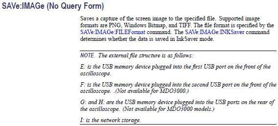

I don't think "ACTIONEVent:..." is the right command. It sets up the scope to automatically save images after an event occurs.
Use "SAVe:IMAGe" instead
I haven't used this particular Tek oscope model, but there is a way to transfer the image directly from a oscope to a PC. It's not a trivial task to program (using FileSystem:Read). I would not suggest trying it unless you are a seasoned programmer. Best bet is to use either Blokk's networking suggestions to remote into the Oscope, or use sneaker net (i.e. USB Drive).

Have a look at this thread. The commands to save a screen capture are likely the same.
Ben64
Cool! If this works, then it is a simple and direct way to make and save a screen capture in one step 🙂
I thought the "HARDCopy" command is only for sending image to printer, but now it makes sense, manual page 350:
Syntax HARDCopy {STARt}
Related Commands *WAI, *CLS
Arguments STARt sends a block of data representing the current screen image to the requested port. The data sent is in the image format specified by the SAVe:IMAGe:FILEFormat command and the compression level is controlled by the selected format (BMP and TIFF are uncompressed whereas PNG is compressed). The HARDCopy:INKSaver determines whether the data sent is in InkSaver mode.
So as I see that "VISA Read to File" just after that HARDCopy command should get the data of the screen image. Kudos!
