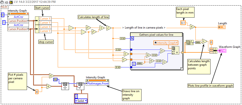

Here is an advanced version of what I mentioned above. It is pretty old code that I just cleaned-up a little bit but you should be able to use it, either by loading a comma-separated file of your own data or by copying the code into your own code.
The default data is a multimode CO2 laser beam. The cursors can be moved to plot on the waveform graph the laser beam profile between the two cursors.
