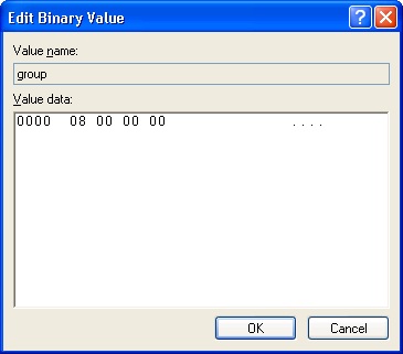

OK, I got the problem.
"RegisterTxt" properties have been removed from the config dialog since Add-in version 3.0(if I remember correctly).
But for compatibility, the Add-in will display "RegisterTxt" if your machine has a history of configuring "RegisterTxt" within earlier Add-in versions (like that on my machine).
I think one option for you is to trick the Add-in by changing a registry key value:
HKEY_CURRENT_USER\Software\National Instruments\Common\USI\ExcelTDM
Please exit Excel and change the key value "group" data to "08 00 00 00". Launch Excel and go to the config dialog, you will find "RegisterTxt" properties under the Group tab.
You can also do the same to "root"/"channel" key values.
Hope this helps,
Mavis
Message 14 of 18
(1,215 Views)
That worked, thank you so much! I knew it would be some arcane knowledge that was the solution.

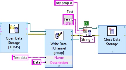

Is there anyway to have the column title be something of my choosing instead of "registertxt"?
Message 15 of 18
(1,196 Views)
For standard/default properties, we cannot change their name displayed as column title.
Fortunately custom properties enable us to do that, but your VI needs a small change. Instead of writing 'FreeTxt' properties, please use 'Set Property.vi'(on Storage>>Advanced palette) to write properties, naming them whatever you want(except those reserved).
Hope this helps,
Mavis
Message 16 of 18
(1,190 Views)
How do I configure this at the group level? I've tried wiring in the VI you mentioned but it results in a broken wire.
Message 17 of 18
(1,165 Views)
The VI may look like this:
If you don't want 'FreeText' to appear as terminals of Write Data, please go to its config dialog and choose them to be ignored.
Best Regards,
Mavis
