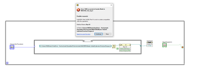

Hello i got the Vi´s Done now and want to build the master but im not getting it done right:
This error occures when i put the Ring and run vi inside the loop.
When i put it outside i got the problem that I cannot change the vi.
It did not swap
Any idea how to fix this? Best regards

There are multiple things you need to do with subPanels, which may not be shown in your images.
  1. You can use the "Call and Forget" mode to dynamically call your VI, instead of the older Run VI method. This will not make a difference except Call and Forget is a bit more modern and allows you set controls when called rather than call another method.
  2. If the VI is already running, then do not call the "Run VI" method to run the VI again, just insert the reference into the subPanel.
  3. When you want to change VIs in the subPanel, you need to remove the VI form the subPanel. There is a method for the subPanel called Remove VI.
You need to decide how you want your system to run. When you select the VI starts and is inserted into the subPanel, when finished does the subPanel VI close, or does it keep running. Do you want to insert VI's that are always running into the subPanel? All of this will affect how you call your VI's.

Thanks for the fast reply. I want to start the master Vi from the desktop. After that the Vi selected by the Ring should be visible i the sub panel and be running until i press stop or swap to the other vi with the ring. Both Vis are using similar output and inputs, just wanted to mention if this effects something.
 Where do i have to place the Call and Forget mode. Inside or outside the loop? Same with the Remove Vi
