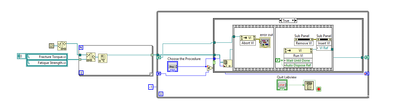

@Julsbng wrote:
So now the Vis are switching when i use the ring, but they are not running.
If i use a Run vi now it is not working. It shows nothing then...
You need to remove, then reinsert on change, something like that:
Message 12 of 20
(950 Views)
thank you i will try this.
You don’t have a connection to the N of the for loop, isn’t it needed or it won’t run?
Message 13 of 20
(934 Views)
Its working perfectly thank you very much.

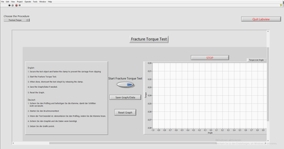

But i still got one issue. The size of the front panels of the Vis are the same size as the subpanel but its not fitting correct when i start the programm. i need to adjust the subpanel with the slider so i can see the whole front panel and not some empty space. How can i fix this? I know that i can do some setting with window size etc but this didnt work maby  i did somethign wrong. I will attach some pictures tomorrow.
Thank you very much for your help so far. !
The trick which I using time to time is to set properties as shown below:
Just set the size equal to the size of your subpanel, you will see gray border which can be used as guide to control that all UI elements placed on the BD are fit with visible area (this border will be not displayed in runtime). Don't forget to set Origin to 0,0 - this will move it to left upper corner  and disable scrollbars if you don't need. That is.
