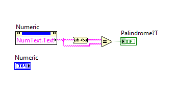

The solution goes something like this.. Am just thinking other possible sol. too, to just iterate the claim Smiley Wink
As in place of 3 functions, we reduce them to 2 functions by removing decimal string conversion and using the NumericText. Text property node. Thereby, taking string form of a number from itself!!
That is still three function, one being a very expensive property node! Make the input a string and get it over with. As a bonus, it will work with almost any number of digits and even detects in any random text string is palindromic at the same time.

2 functions (1 p-node)
Spoiler
"Should be" isn't "Is" -Jay

Yup, Ben.. this was the first thought that came into picture.
Instead, of all this logical method of analyzing we just just straight away make the user right in a string control with artistic liberty, with some limitations written on the *terms and conditions view. Smiley Very Happy
Spoiler
If am not mentioning it wrongly..
Why was it named Spoiler ?! Smiley Surprised

OK So Great minds think alike
(Interesting cross-post)
How about 1 primitive? no fair peeking.......
Spoiler
