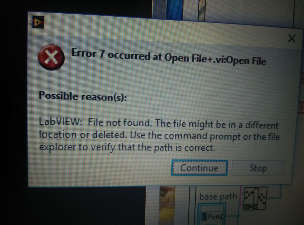

Can you describe really what do you want ?
This error appear when file is not in the path that you specified.

@Mayur789 wrote:
1505985093091-856571008.jpgthis is happening after doing that. I connected a indicator to it and it is reading it there.

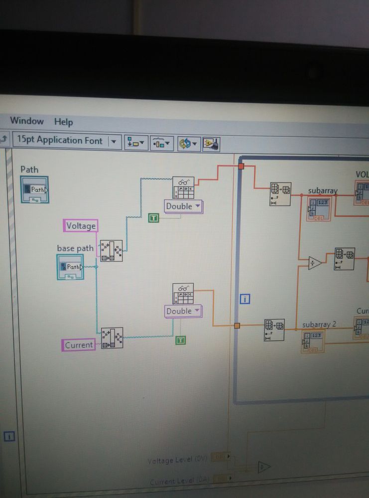

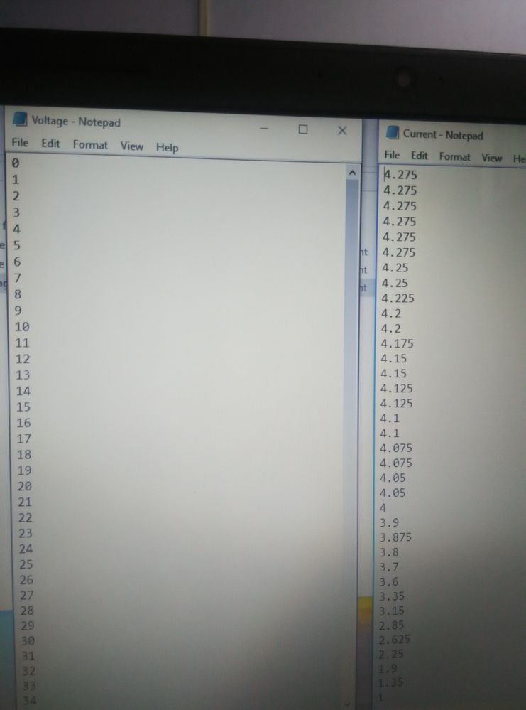

These are my values.1505987494385-1421253687.jpgand this my vi photo sorry my PC is not connected to interet1505987672641-1965943816.jpg

ok Mayur,
If your path is correct (you must verified), add the extension ".txt" to relative path "Voltage" and "Current".
I think that is your problem!

They are in .txt only.

In your pictures we can see voltage, Current constant in the relative path.
change this to have Voltage.txt and current.txt.
test it and let me know if you have a new error.
