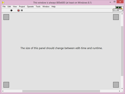

  1. Create a new VI (or see attached);
  2. Configure VI properties to hide menu bar, toolbar and scroll bars at runtime;
  3. Go to VI Properties > Window Size and click Set to Current Panel Size button in Minimum Panel Size group;
  4. Go to VI Properties > Window Run-Time Position:
    1. Set Position to Centered;
    2. Uncheck Use Current Panel Size option and click Set to Current Panel Size button;
  5. Click OK button to apply changes;
  6. Enlarge FP window a bit in any direction;
  7. Run the VI.
Expected Result:
Panel size equals to values set in VI Properties > Window Run-Time Position (or Minimum Panel Size, as they are equal).
Window shrinks to panel size.
Actual Result:
Panel size equals to Minimum Panel Size + size of hidden items (even though they are hidden):
The window can be shrunk to expected size manually at runtime.
Workarounds:
  • Set Minimum Panel Size = runtime panel size - size of hidden items (-17 for Width, -63 for Height) or less;
  • Check Use Current Panel Size option at VI Properties > Window Run-Time Position.

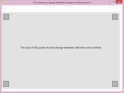

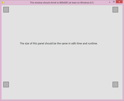

Actual Result:
Both window and panel size stay the same between edit-time and runtime.
If the VI is configured to allow resizing (see TestWindowSameSize1.vi), hidden items appear drawn in a window, but they're not functioning:
If the VI is configured to restrict resizing (see TestWindowSameSize2.vi), hidden items are hidden properly, but there is a white space in place of them:
Workaround:
Enlarge FP window a bit in any direction, so that edit-time window size != runtime window size.
