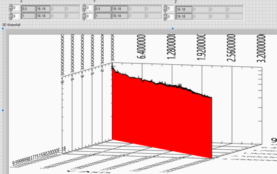

I want to creating a 3D waterfall graph with data from an excel document, but the result is not as expected. I create a labview program to take data from different excel sheets. Each sheet contains data for x, y and z axis for one measurement. I want to display data from five measurements to one single graph like in the attached image. How need i proceed?

I put that header to show you what those data means. Before i run the program i delete that header because is not numerical format. After running the program it gives me this representation of data like in the picture and i don't know where i am wrong...
I remove the frequency data for Z axis because the program gives me a straight line if i let them there. I want to display mutiple trends on a single 3D graph like in the first picture.

The excel contain one waveform with three dimensions x,y,z. Each sheet from excel contain datapoints for x, y and z axis. First sheet contains data for Z axis, next sheet for Y axis and the last one for X axis.

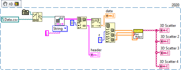

I'd start to simplify the data.xlx to a csv gathered onto one page...
 the x,y,z datapoints of one waveform will be scatter around the xyz volume if you interpret those columns as vectors
