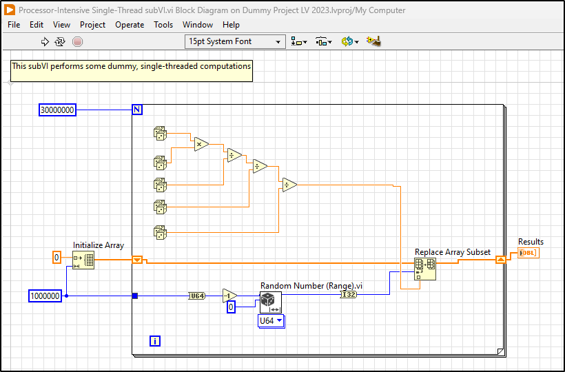

I created a VI named Implicit Multithreading Main VI.vi that calls multiple instances of subVI Processor-Intensive Single-Thread subVI.vi. The subVI performs dummy single-threaded computations, simply to keep a virtual processor core busy for around 10 seconds.

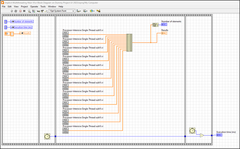

Running the code on machine 1
I created and initially ran the code on a desktop machine with 12 virtual cores using LabVIEW 2023 Q3 32-bit, running on a 64-bit Windows 11 machine. There are 12 instances of the processor-intensive subVI in the Main VI, one for each of the virtual cores. When the subVI's execution is set to non-reentrant (the default), running the Main VI results in the CPU experiencing around 8% utilization. This is as expected, as 100% / 12 cores = 8.33%. Using the Threads tab in Process Explorer I can see that a single thread is utilizing all 8%.
The unexpected results occur when I switch the subVI's execution setting to Shared clone or Preallocated clone reentrant. With either of these settings, the Main VI continues to fully utilize a single thread, resulting in around 8% CPU usage.
The behaviour changes when enabling the "Inline" setting of the subVI. When running the Main VI LabVIEW now utilises 12 threads at around 8% each, for a total of approx. 100% CPU utilization, which is what I expected.
Running the code on machine 2
Machine 2 is a laptop with 8 virtual cores running LabVIEW 2023 Q3 64-bit on 64-bit Windows 11.
In the Main VI I diagram-disabled the bottom four instances of the subVI, to have 8 instances being called - one for each virtual core.
When the subVI is set to Non-reentrant, Shared clone or Preallocated clone reentrant, the CPU utilization is around 37.5%. When the subVI is set to Inline, the CPU utilization is around 100%. Unfortunately I don't have Process Explorer on the laptop to see how many threads are being used by LabVIEW. The 37.5% figure suggests that perhaps 3 threads are being used (3 threads / 8 virtual cores = 37.5%).

Screenshot 2: The Main VI calls a number of subVI instances equal to the number of logical cores (12 for machine 1, and 8 for machine 2)
Screenshot 3: The processor-intensive, single-threaded subVI. It performs dummy computations to keep the processor busy.
Please note that the "Random Number (Range)" VI has the "Inline" setting turned on. The multithreading behaviour doesn't change when that VI is diagram-disabled.
