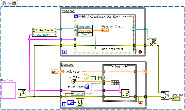

If you only have 1 loop and in that loop you are reading a value from some hardware then you have to be constantly polling to get this value, in that case it seems pointless to have the Event structure in that same loop? Like Schubert i assumed that you had multiple loops and that you was struggling passing the value from a 'Daq Loop' to your 'Event structure Loop', something like:
If you have a loop with lots of events captured by an event structure and you simply want to send the value of a reading from your hardware to that loop then the above will do that. If you are reading from an external piece of hardware then you will have to have at least 1 loop polling the hardware. If you have the same logic that calculates whether it is a new value then fires an event in the case structure then you might as well have the event case logic in that case structure? I dont know if i am missing something here.
I will attach the above example just in case this could be something you could use. In the bottom loop i have used an 'Approx Equal' vi i wrote. It is well documented on this forum the perils of using equals function to compare doubles. With this vi you can set the level of decimal places it equals to, you can also set round Up/Down/Nearest. In the example above i stop the bottom loop by destroying the 'User Event' this causes the bottom loop to error, stopping it. The User Event consists of a cluster of 'Daq Value' and 'Error', the error boolean is used to stop the Main loop in case of an error in the Daq loop. I also 'Unregister User Events' when exiting the main loop, im dont think this is necessary as we will be terminating, i do it anyway just in case. This is normally used to dynamically remove events.
Hope this helps,
Rgs,
Lucither.
