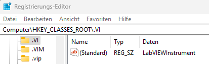

We can «fix it», but I should first explain how it works. There’s no rocket science here.
The *.VI file type is registered in Windows under the Registry key HKEY_CLASSES_ROOT\.VI:
Below also see the according LabVIEW Instrument entry:
when you double-click (or press Enter on) a VI file, Windows checks the extension from the first entry, proceeds to the second, and launches LabVIEW as if from the command line.
It’s important to understand that these two keys are updated every time LabVIEW starts. If you work with multiple LabVIEW versions, the most recently used version will always be launched-this is how LabVIEW “remembers” which version was last used.
I rarely use double-click myself, but when I do, it’s annoying that the “wrong” LabVIEW version is launched sometimes.
Additionally, when LabVIEW is already running, then I’ve seen with Spy++ that, in this case, all open LabVIEW windows receive a WM_ACTIVATEAPP message. From that point, I’m not sure if this is really a LabVIEW issue.
Anyway, let’s take everything into our own hands. The idea is simple: I’ll replace the «default» LabVIEW launcher with my own. This will also help me in the future to launch the correct LabVIEW version according to the VI’s saved version.
First, we’ll change the HKEY_CLASSES_ROOT\.VI (Default) key from LabVIEWInstrument to LabVIEWHelper:
But manual replacement replacement only works until the next LabVIEW start. Therefore, I’ll develop a small resident app that continuously overwrites this key (every 5 seconds). As I’m learning Rust, the code will be in Rust (you can do the same in LabVIEW). Not very elegant, but fine for a Sunday morning exercise:

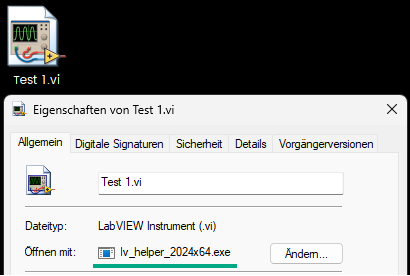

Now, instead of LabVIEW, my own application will be launched in the background:
this will launch LabVIEW, resolving the issue:
The only disadvantage — if you work with [allowmultipleinstances=TRUE] (which is OFF by default), this will launch a separate instance for each VI.
I’ll attach the complete code, executables, and reg files.

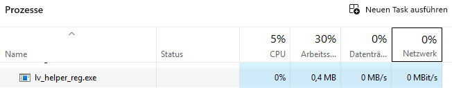

Place both lv_helper_reg.exe and lv_helper_2024x64.exe into the LabVIEW folder:
Launch lv_helper_reg.exe, it will stay in memory, using 0% CPU and about 400 kB RAM:
good idea to add it to the startup folder. The easiest way is to press Win+R then type `shell:startup`:
