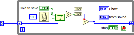

I need to count the times I press the true button for saving data. If I still pressing and the loop time is 1 s it continues counting the true times, but I only need to count once each time I press true button.
I share a small example from my code for better understan.

Hi CPalka,
so you only want to count rising edges?
Use quickdrop to easily place "BooleanCrossing" in your VI…

All you probably need is set the button to latch action. No extra code needed. (right-click...mechanical action ...)
(Also note that counting should be done with integers (blue), not floating point numbers(orange)).

Hi altenbach
I need to save data until  releasing the saving button.
Well, you never said that. 😄 I assumes that pressing the button would just add one log entry, for example.
You still don't need all these subVIs and complicated code. Here's how I would count how many times the "switch until released" button went from false to true.
