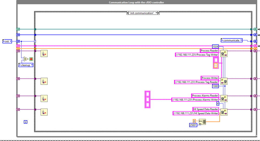

We noticed that in the block diagram, a “network stream endpoint” has been created to communicate as shown in the figure below(picture 3).

I expect RIObotics is right, and changing the cable is perhaps the easier solution, but you can also solve it by adjusting the IP addresses in the Network Streams address strings.

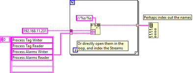

Since you might want to change this (again) in the future, consider having a single location define the remote IP address and using something like Format into String to build the connection strings, e.g.
(note I suggested in the comment you could open them in the loop, but that depends on the datatype, so probably not practical in your case with varying datatypes).
This sort of code would make it easier to switch between IP addresses.
Since you asked about allocation, you're currently using DHCP, so it's possible (although perhaps not likely, depending on your router etc) that your cRIO address will change.
Static allocation might be a better choice, because it would allow you to ensure this doesn't happen
