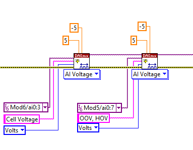

I have a cRIO 9045 and a couple NI 9224 AI voltage modules. They work as you'd expect when hooked up to a voltage source and when you short a channel, but things get weird when it's an open circuit. For some reason the open circuit voltage reading is ~1.47 volts and I've never been able to make any sense of it. We have another cRIO with a few NI 9224 modules, and my coworker told me that he's seen the same thing on that one.
I don't think it has anything to do with the DAQmx code, but here's how the channels are configured just in case:

NI does not specify what voltage a device will read when there is no signal connected. See Incorrect Readings on Unconnected or Open Channels of DAQ Device

Huh, so I guess the solution really is to just live with it. Thanks for the link!
