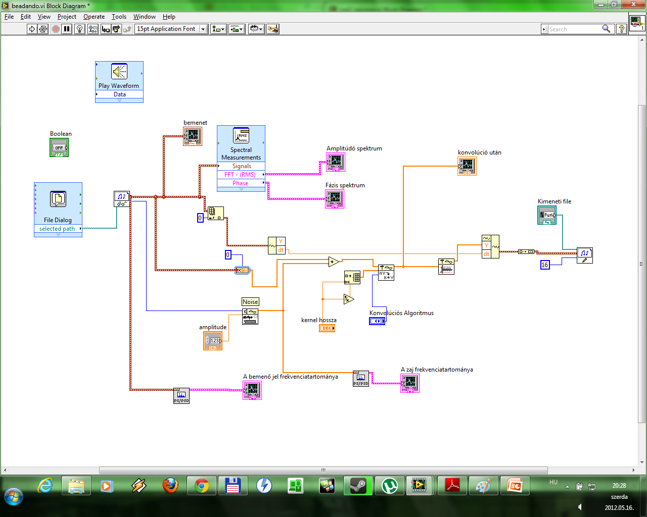

Hi. I want to do a moving average filter to my VI. I have done a basic FIR filter.. but i havent any clue how to do a moving average filter.
+ I want a button for play  the input wav file.. how can i make this?
This is the vi :

My trick for a moving average is to use the FIR filter with specific coefficients.
As far as playing your wav file, check out the Graphics and Sound palette.  I have little experience with them, but I know there's VIs there to play your wav file.

Ok i have found how to play the wav file, but this play it immediately! I want a button and when i push it then schould play the input wav..
(13,443 Views)
You need to put your Play waveform inside an event structure.  The VI will wait at the event structure until something happens such as the Value change of a boolean Play button you put on the front panel.
