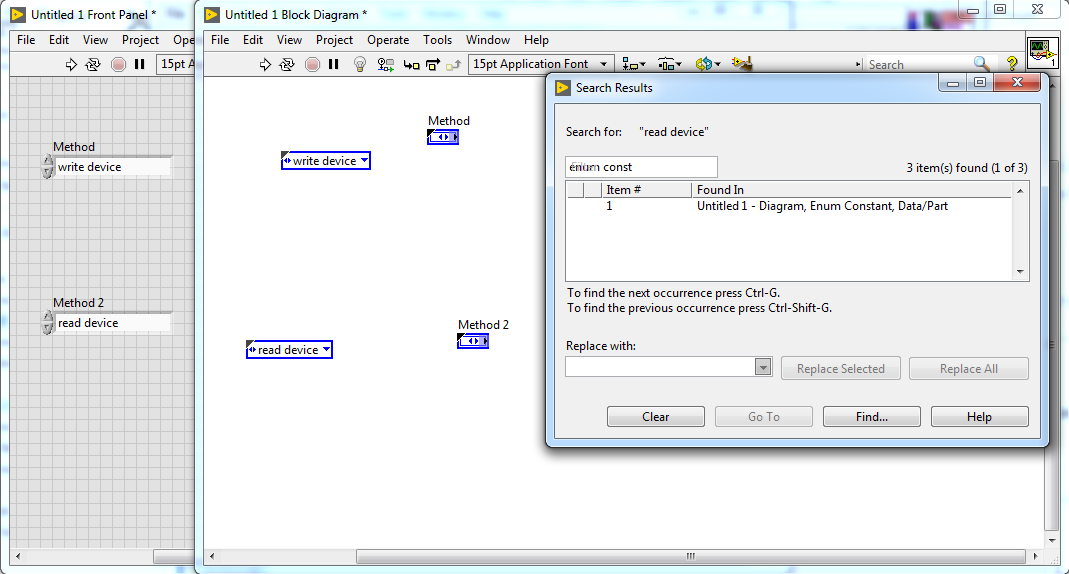

Filter Search Results.  I've known about this for a bit, but noticed it is an official feature in >= 2016.
Lets say I have an typed enum and I want to find all times that there is an instance of this enum as a constant with the value of "read device".  I can create a search for the string "read device" but that will bring up all times that is used on controls, indicators, VI description, comments, etc.
Now I can type "enum constant" into the filter and only find enum constants that have the text "read device".  There's limitations in this case like it will find all enum constants with "read device" and not just one strict type, but still it narrows the search.
