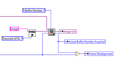

How does one go about reading images from a genicam buffer after stopping acquisition?  My my camera is generating images faster than I can read them.  I stop the acquisition, but I don't close the session.  However, when I go to read the buffer, I'm told no acquisition is in progress.  That's correct, but there are still images in the buffer.  The code section below works fine during acquisition.

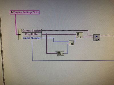

I am clearly missing something.  My understanding is that the camera (FLIR Blackfly) has a buffer that stores images on the camera and I read them from the buffer to my PC..  If the camera is generating images faster than I can read them down, the buffer fills or loops back on itself.  At some point, I need to stop acquisition so as not to keep filling the camera buffer and download the images from the camera.  In looking at what it takes to create a ring buffer, it appears you create an array of images on the PC?  If that's the case, then somehow the images got from the camera to the PC fast enough to populate the buffer on the PC.  If so, then why do I need a camera buffer?  Assuming I'm missing something, I still need to stop acquisition.  For every configuration I've tried, if I stop acquisition and then try to extract images from the camera I'm told that I cannot do so because there is no acquisition in progress.  I've tried three variants of the code.  Using extract image, the code gags and tells me that it only works with a ring buffer - which is what it was configured with.  All the other methods I've tried work in that I can get images from the camera until I stop execution.  Code sections below.  I'm at a loss.
Create the ring buffer.  If the ring buffer is local to my PC, then somehow the images have managed to get from the camera to the PC and I don't need the camera buffer or is this used when I configure the session to tell the camera how to setup the buffer on the camera?
Configure the session.  I've tried any number of variations.
Extracting from the "local" ring buffer if that's what it is with grab works, right up until I stop acquisition.
The extract image crashes and tells me that it only works with ring buffers, but I use configure ring buffer when I start acquisition.....
This variant works too, until I stop acquisition.
Am I just misunderstanding how the camera works and I cannot do this?

We cannot figure out what you are doing based of the photos made of your screen, you will need share your VI for that (for preferably in LV2015).

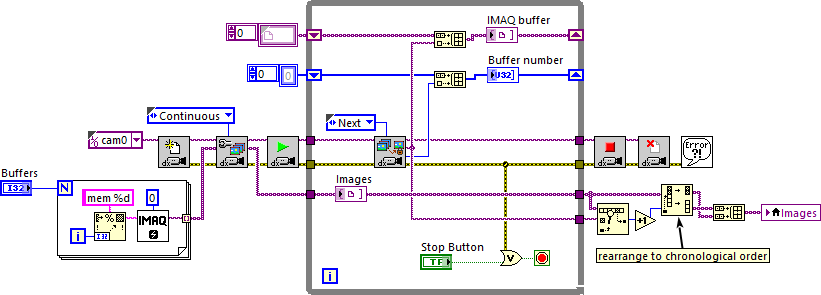

I made a small test that you can try for yourself. The name "Buffer Number Out" is misleading in the context of a ring buffer because it will outgrown the number of buffers set, "frame number" would have been more logical.
Example with ring buffer size set to 6:
(842 Views)
Thanks for the diagram.  I've tried that.  The problem is that once you stop acquisition, you can no longer read the camera buffer.  I don't close the camera session, I just stop acquisition.  I use high speed cameras that collected images faster than what my PC can download.  I can read the camera buffer, see that I have hundreds of images in the buffer but have only downloaded a fraction on them.  There may be no way to do this in LabVIEW using the VIs that are provided.  I can do it using Python but my Python code uses the SDK specific to the camera.  As you mention, the LabVIEW routines are Genicam agnostic.  They simply may not be written to accommodate this functionality. If I know that it cannot be done, I can stop trying.
