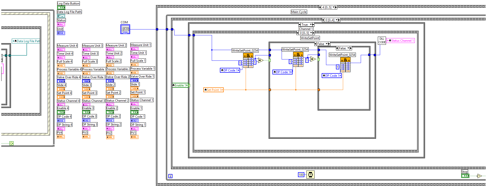

Ajaj 🙂 We just ordered 3 new Brooks GF80 MFCs, but with analogue control options (version code: "S4": 4-20 mA input/output pins + RS485 option), so at least these new models do contain analogue options (GF80-81). However, I plan to control these 3 MFCs from LabVIEW, but via the Brooks controller modell "0254" (Controller 0254). So I plan to connect my PC to this Controller unit via RS232. I just had a look at the provided LV "driver" at their website. Very amateurish work, messy code and DLL calls: Brooks LabVIEW .
Have a look at their "application example". I just show one part, but this is going in the same way all over in the whole code (trying to call 3 times the DLL function with the same parameters, and checking whether it worked or not... It should work at once, not??? Smiley Surprised ) I started to be worried about your post Ben, maybe this is the same symptome what you experienced?

That looks exactly like the situation I ran into blokk !
BTW, it did not always work after three attempts with the version of firnware we had for the 0254.
Thank for providing supporting evidence blokk !

Well, I will get the 3 MFCs and the 0254 Control Unit from Brooks in ~5-6 weeks. I will test it, and if I do not get proper communication via their provided "driver" dll, I will complain. Either they are going to fix the problem or refund...
But lets hope it will work. For sure, I will post my experiences in a separate post, if I face something which might be interesting to other LV programmers.
I am not really an expert in how these companies create their HW drivers for different languages. I wonder, why Brooks uses a DLL call instead of basic VISA functions with string commands. I already used MFCs, pressure sensors from MKS, Pfeiffer, Leybold. All of them provide LabVIEW VIs with proper VISA communcations for RS232... Do you think, it would make any difference, if I tried to program myself a driver for Brooks device using VISA functions and their manual for RS232 protocol? Or the problem is not in the DLL itself, but in lower level in the HW?
