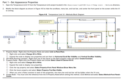

Not sure where I've gone wrong here. Firstly when I open the VI it looks different then the picture supplied, step 1 tells me to right click and change a property node however there's nothing to right click to change.

Correct I read that also however that doesnt really show me what functions I need to add, I havent seen those before. For ex. below it tells you more or less exactly what needs to be done.

Hi AD,
You need to add a property node (use Quickdrop!). Then do what bullet item 1 says about linking…
Bullet item 3 also is a property node, while item 4 is an invoke node
