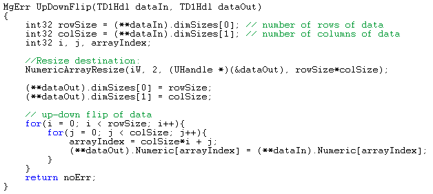

I'm trying to use CIN to up-down flip a two dimensional array passed from LabVIEW.  Everything seems to work fine when I run the .vi (flipper.vi).  However, when I run another .vi (save_data.vi) that uses the flipper subroutine, it crashes LabVIEW.
Specifically, I recieve a LabVIEW.exe - Application Error:
The instruction at x-location referenced memory at y-location. The memory could not be "read".
Now I understand that somewhere along the lines LabVIEW accesses corrupt memory, due to a lack of array initialization or something. Unfortunately, that's about all I understand.
I'm using LabVIEW 8.0. Here is my flipper CIN code:

Let me know if you have any ideas on how to possibly initialize the data that I'm passing into the CIN.

Hi, mrod,
The destination array should be resized before writing values with NumericArrayResize function:
The code above should work without troubles (hopefully).

Hi, Andrey.
The NumericArrayResize fixed the error I was getting. Thanks so much.
