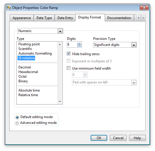

To do this, you would go to the Properties page for this control (or right-click on it and select Display Format) and choose something like SI notation:
The result is disapointingly, nothing.
