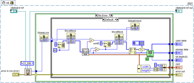

Hi Rolf,
I'm having an issue with colors.
I thought was because of the resize function I used, but now i believe the color table produced by this library is not correct.
Original:
After passing thru clipboard:
the code:
 What do you think about it?
