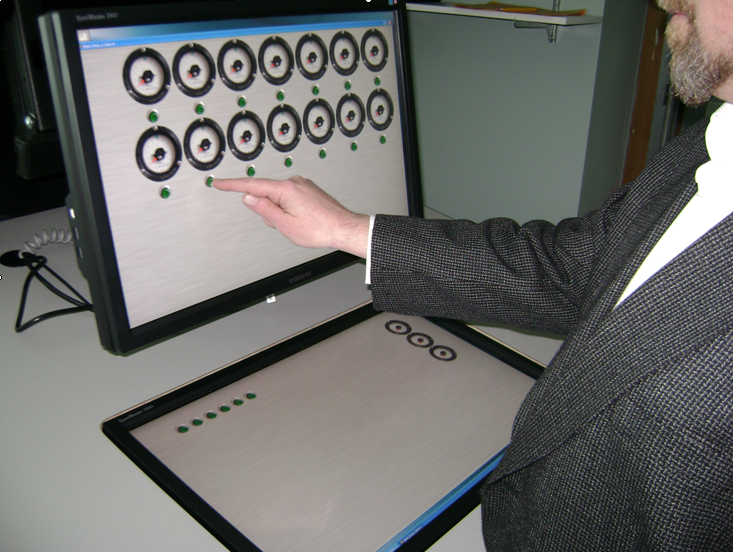

I can not leave this topic without again saying that "Controls on the Fly" application carry a large development effort to get them to work correctly.
Here is an image of one of my extreme versions of Controls on the Fly developed explicitly for touch panle interfaces (there are two shown, in this image)

What I should have mentioned is the above was developed using LVOOP so I can add new controls to the application "On the Fly" by adding additional LVOOP objects to the folder where the exe lives.
I suggest anyone else approaching a challenge like this seriously concider using LVOOP since there are many shared opeartions for controls that can be realized by inheriting from the parent class.
