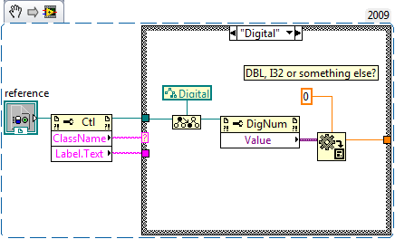

Is it possible to find out if a digiatal control is an integer or a double value?
When I have the Reference to a Digital Control, how can I find out the Representation of it's value(e.g. Double, Integer32,...)?

Activate VI Scripting (LV Options) and you will have access to a property called "Representation"....
Please note that you should only read this property for running VIs!

@Alexander: That is not true for I64/U64. Also I want to save the data to file and save memory.
@Norbert: I will try this out. Is there a reason it is not possible to get the representation without VI Scripting?

C:\Program Files (x86)\National Instruments\LabVIEW 2015\vi.lib\Utility\Data Type\Get Type Information.vi

Yep. The location and the VI paul_cardinale suggest works. Kudos paul!!!
Though there is no Data Type Folder in my PC (Running Win7 and LabVIEW 2014)
C:\Program Files (x86)\National Instruments\LabVIEW 2014\vi.lib\Utility\GetType.llb---->Get Type of Control.vi will help you to determine the Representation of the reference.
