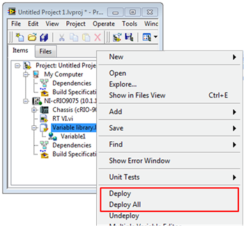

Hi Les,
You need to either:
-Manually deploy shared variables from the Project Explorer window by right-clicking on individual variables and selecting Deploy, or by right-clicking the library and selecting Deploy All.
Or, programmatically deploy the library from the host PC using an Application Invoke Node and specifying the IP address for your real-time target:
This KB outlines these steps:
Error 1043 when Programmatically Deploying a Shared Variable on a Real-Time Target

Hi bkercher
In this very simple project there are no shared variables and it is not a Real-time application;  I suspect that is is simply a case of the method not being supported by the runtime engine.
Many thanks for your response to this thread.
