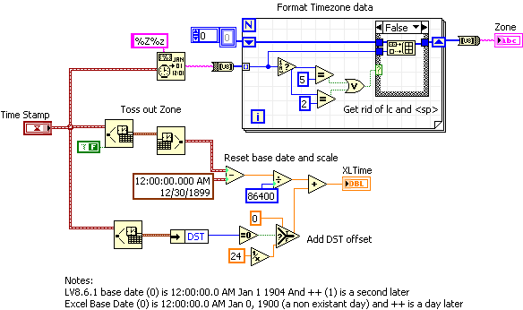

Ok
the basic problem that I see is the the LabVIEW TimeStamp type is a cluster.  Converting it to a dbl gives you a value in seconds elapsed since 1904 Jan 1 12:00AM GMT and, your spreadsheet cannot interprate that (or display that) as a "TIME."   So, you want to convert it to a string (easy TS->String check the help for format options) BUT, you might want to pass all of your data as numbers into your spreadsheet so you can post-calculate or graph other outputs vs. TIME!  This little chunk of code .....
 converts a LV Timestamp to a number that Excel interperates as "the amount of days elapsed since 0 Jan 1900 @ 12:00AM LOCAL."  You will need to format the cell in Excel to display it as a date-time But it can be operated on and graphed against with only Excel's limitations (Excel followed the Lotus bug of erroneously assuming 1900 was a leap year, and Leap seconds are unrecognized)
Enjoy!
