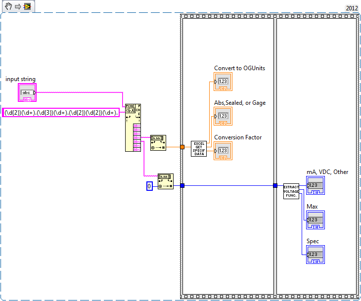

Accepted by topic author buickgn
So I tested your code, and individually they work, like you said.  So I did the following:
And now I do not get the error on the variant.
I haven't looked too deeply into this, but it looks like something in your VI's is not thread safe, so ensuring they don't run at the same time solves the problem.
I hope this helps.
