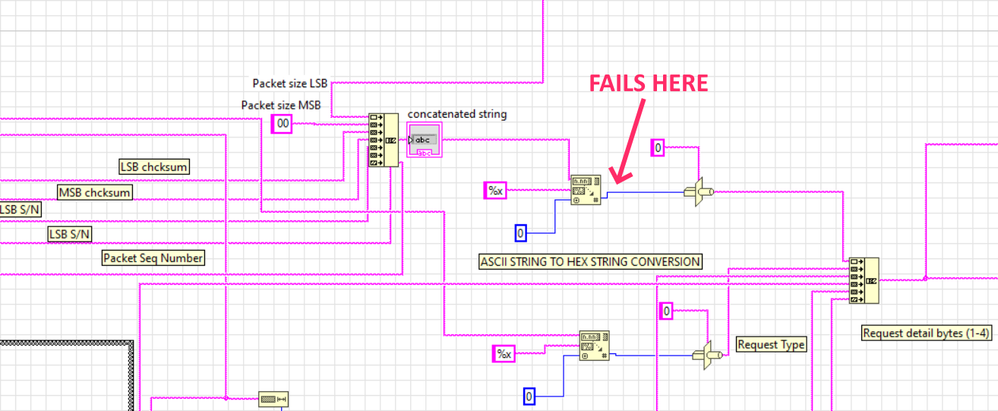

ASCIItoHEX.pngI'm working on a vi someone started last summer and I'm having trouble understanding a section. I'm also limited in my LV knowledge at this time. This vi assembles data packets from text inputs. The left string concatenator makes the header bytes and they're input to a 2nd concatenator which also adds the request and additional data bytes to the string. It seems like when I get too many, or big numbers in the first section it fails between the scan value and type cast objects on the blue DBL line. I don't know if there's a magic setting in the scan value object to get it to work, or if I should break apart the 1st concatenator and add all those bytes to the 2nd one like the request byte is added. I have no doubt many many people have done this in the past so I'm pretty sure there's a known method floating around. Thanks!

Hi Andy,
How does that String function "fails"? (It cannot "fail" as it will always give an output value!)
Which value do you expect in the blue wire and which value did you receive instead?
Can you supply a VI containing a string constant with typical data for this string conversion function and can you mention the expected output for those typical data?
Can you supply a manual describing the data you need to build into this "request"?

If that concatenated string is build out of bytes, you're not converting hexadecimal characters to a number.
That MSB string , 00, is that a hex string containing a single byte (\00) or a normal string containing two bytes (\30\30)? It really helps a lot to make the radix visible on string constants (when it matter).
It also makes sense to work with byte arrays, as these are bytes, not strings. In C, those bytes are chars, but in LabVIEW we have I\U8 bit integers...
If you want to get a single byte\character from that string to a integer, simply use Get String Subset.
ASCII STING TO HEX CONVERSION doesn't really mean anything. Hex data in a string is still ASCII.

Hi Gerd, thanks for the reply. I don't know which vi to send since they're all in various states of not working so I'll start with what I was given. The only thing I added was the "not used" byte that seemed to be missing. This works with the data entered in the text boxes for initializing the equipment. I set the text boxes to default to initialize. My mission is to increase the number of data packets so I can send enough data to actuate the device. My expanded version works to initialize the device, but if I try to send enough data to move it I get "FFFFFFF" at the output of the scan value object from the 1st string concatenator. The picture is data for moving the device.

I think you'll have to use Scan From String, and use %2x.
The hex string to number scans as many characters as possible, and then fits it in the wired type. So even if you wire an u8, it scans more then 2 characters.

I was working with my expanded version of the vi and noticed everything works until you add one additional "00" to the req details (7th byte) text box. After that I get "FFFFFFFF". If I just have 6 req details filled with "00" all is well. I'm totally stumped at this point.

Hi Andy,
You are stomped much earlier!
See this:
This is so much more compact than your code - and that's only the "left" 15% of your code! )Note the scrollbars of the window!)
All the remaining code needs to be cleaned up the same way!
Why are there SO MANY Rube-Goldberg constructs in your code??? I left some of them in the image for demonstration…
Btw. why do you work with strings all the time when you want to handle bytes (aka U8 values) instead???

I'm not understanding why you have so many inputs for the data.  Why not just have a single string control, set the Display Style to "Hex"?  Then so much of your code is not needed.
