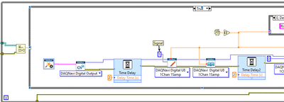

Let me provide background to my project first. We have a conveyor belt we are controlling using LabVIEW programming. This specific part of the programming is to divert packages left and right. We are sending digital signals through a DAQ to the conveyor to do this, and it is working so far. For this diverting function, a photoeye sensor is read (bottom while loop in images), and once the sensor is covered by a package, it triggers the top while loop/case structure. This loop tells the conveyor to wait 2 seconds (to wait for the package to get the divert zone), then triggers the divert (by sending a digital signal to the conveyor), then waits 2 more seconds, then tells the diverting to stop. This system works and has been working fine for the most part.
(Note: These digital signal commands are through our DAQ company's SDK for LabVIEW, so don't pay much attention to it in the image below, it won't make much sense).
Here is the problem. This method does not account for if packages are too close to each other. In other words, while Package 1 is diverting, Package 2 could be crossing the sensor at the same time. But the program doesn't use Package 2's sensor signal to trigger the case structure process while it is being carried out for Package 1, so the diverting never triggers for Package 2. I want to make it so if Package 1 is diverting, Package 2 can still cross the sensor, and send the command to the top while loop so it can divert according also.
I have tried methods using Notifiers and Dynamic User Events, and either they didn't work or I wasn't using them correctly. Does anybody have any ideas on how I can accomplish this? Any input would be helpful. Thank you.

Try bundling a timestamp with your "Pre-Divert Zone Sensor" trigger Boolean. Instead of waiting a fixed delay, wait the necessary time from the trigger time.
If the packages are very fast, you may have to turn that stream of triggers into a queue.

Hello Doug,
I tried the queueing and it does not seem to be working. Once the sensor is covered, it queues the true signal to trigger the diverting function correctly. However, it stays true and I can't get it to queue false signals after to make it stop, so the diverting function just turns on and off every 2 seconds. Below is my code.
Any thoughts as to why it's not working? I have never used queue before. Any help is much appreciated.
