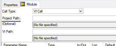

For documentations sake, this page explains what you are seeing and why:
https://www.ni.com/en/support/documentation/supplemental/13/how-teststand-interacts-with-labview-app...
If you didn't call the VI's in TestStand using a "Project Path", even though they are in a project, they would share the same application space.Instead you can just specify the vi path, and you'd be good to go.
That would be the simplest solution...

What I understand from ShockHouse is that does happen if you define the project path, but not if you don't.
