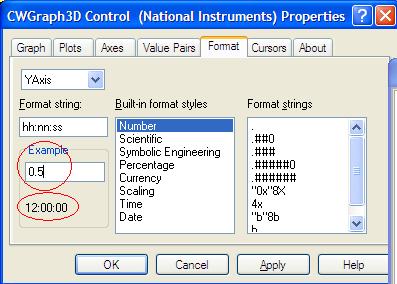

A) When trying to do anything new with a CW 3DGraph I start by opening the CWGraph3D properties screen.
B) The location within this dialog box tells you how to prgramatically access any of the porperties. Stop and take a look at the structure that was used to create your plots and compare that with the tab layout. This relationship is pretty much 1 to 1.
C) I did not know how to display time on a 3D graph so I found the "Format" tab selected a time format and then started entering some values into the "Example" field to see what kind of results I got. After a little playing I realized that the time is expressed in units of days. In the image shown you will see that a value of "0.5" gave me result of 12:00:00. Similarly 0.25 gave 6:00:00.
D) I modified the example I posted earlier to illustrate how I would convert seconds to days. I am including a screen shot showing the results.
Final thought:
You seem to be having trouble getting your time into a numeric format. The VI's in the attached image existed in LV 5.1 and will help you do your time conversion. I will leave that as an exercise for the reader.
