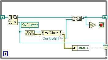

Not the prettiest peace of code, but effective.
Use the array to find the first true. Then use that to index a label, reference, or whatever...
Note that if you signal values, there can be 0..n changed elements instead of always 1.

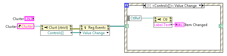

You can feed that array of references into the register for event node. That event will trigger on value change of any individual element and give you a reference to the specific element that was changed.

While all of the above are sound there is another option.
Register different events for each of the things in the cluster.
Let LV detect the change so when the event for the contained item changes we know exactly what needs to be done and no reverse engineering required.
Ben
