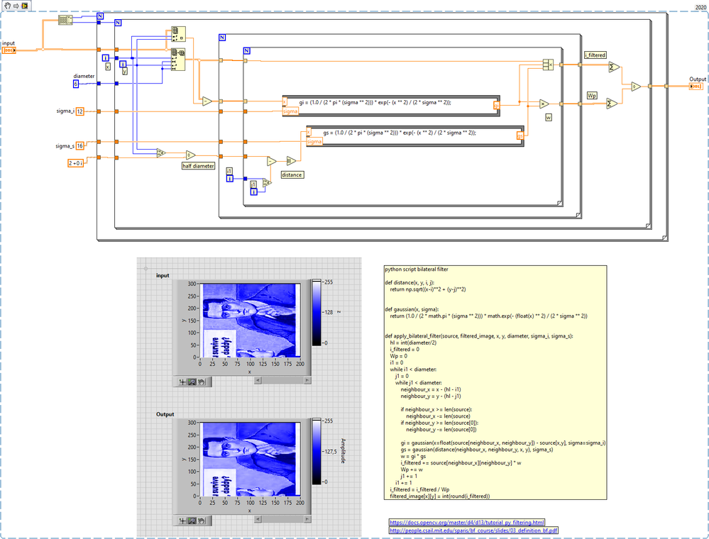

this is an attempt to translate  gptshubham595 's python script to labview
EDIT: if I feed the coin.jpeg into this .vi, the output is slightly different than in the actual python script
Message 23 of 26
(1,428 Views)
I forgot this part in my snippet above:
I read the image in labview, normalize to 255 and feed this 2d array to the python script and to the labview code.
the calculated output is similar but not identical:
attached as .zip is the correct .vi, the python script without opcencv img.read and the coin.jpg

@altenbach wrote:
I think all you need to do is a 2D convolution with a 2D Gaussian. Code should fit a postage stamp. No Python.
I'd love to see a solution based on
https://zone.ni.com/reference/en-XX/help/371361R-01/lvanls/convolution/
the issue with this is, that the kernel is not a constant (as it is usually), but does change from position to position when moved accross the input image.
@gptshubham595 wrote:
python was giving better result don't know why.
I suppose, we could test this with the opencv implementation as ground truth.
